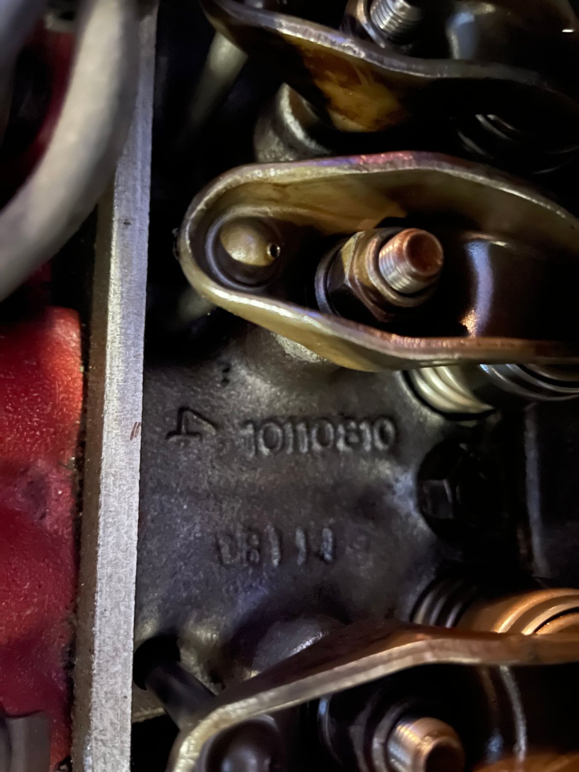

after a number of years, searching for concrete information on these heads, I finally was able to compile enough good data and wanted to share an update this post.
I have these heads on a 355 TPI. They are decent fuely heads that have a better a advantage over the other 2 swirl port heads 191 and 193. When combined with TPI heads you get a nice torque monster. 1991 Gen 2 Cast # 10110810 removed from 350 TBI Truck
Specs: 1.94 intake / 1.50 exhaust 64cc
sodium filled valves
flow 146 Exh @.500 (& 166cfm Inlet)
1.5:1 Rockers Hyd Valves
3/8 valve stems with rotator
Intake angled center bolts for TBI and TPI
these apparently are considered to be the first generation of EFI swirl ports they don’t have as much restrictions as the others.
note, my casting number is vertical and have the 1.94 valves.
