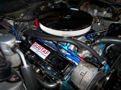

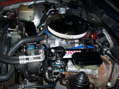

I'm kinda stumped here....The engine wants to run hot, and I can't figure it out. It's not boiling over but runs around 230-235ish while driving and will get to 240 (next dash up from 220) when idling. Engine actually feels pretty hot and hoses are tight as a drum due to the pressure and heat, but not boiling over.
Fan is running constantly after it warms to 220 and water is circulating. New water pump, temp gage sender, radiator is a Autozone replacement about a year old. Doesn't seem to matter where I set the timing at. Air dam in place.
Engine does smoke a bit which is another worry. Kind of a whitish tint to it, and droplets of water can be seen shooting from the tailpipes when initially started when cold. As it warms up the water disappears and the smoking seems to become fainter. At first I was thinking bad head gasket (ugh), but no coolant loss that I can tell. I even put a peice of tape on the coolant resivoir at the coolant level and check it after the thing cools down, and it goes right back to the mark.
Engine seems to have plenty of power when driving it but hogs gas like no tomorrow. I drove it for about a half hour or so before work today and it didn't overheat - I was watching the gage closely.
If I had to guess, the engine has around 3 hours idling while I was trying to set timing and carb, and I've driven it maybe 30 miles now. I pulled all the plugs and they look all look black. I figure it's because it was running pig-rich when I first started it and I think it still is, just not as bad.
Any ideas? Sorry this is so long but I want to give as much info as I can.

Hit 12's yet?? Here's a couple of pics - Still trying to figure out a way to get my dual snorkle air cleaner to fit on it.......

One more (cheap chrome lol).....

Pics show a v-belt...but great insight!
Maybe they gave him a serpentine belt pump??? I didnt notice that its an 83...
