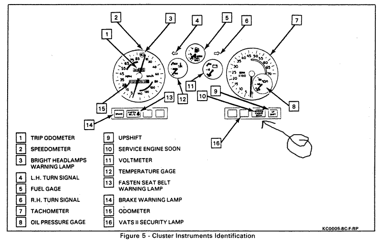

You are correct sir, the ALDL is under the dash by the right knee. When done properly, you will notice that the Service Engine Soon (SES) light will be happily flashing at you from the idiot panel to the right of the steering wheel. Do not be alarmed if the following picture does not exactly match the set-up in your car. It is only a reasonable facisimile used strictly for training purposes only.

Thank ya lol, diagram is a tad off considering I have digital dash but yea I get the idea

That is why I said it was only a reasonable facisimile used for training purposes only.
