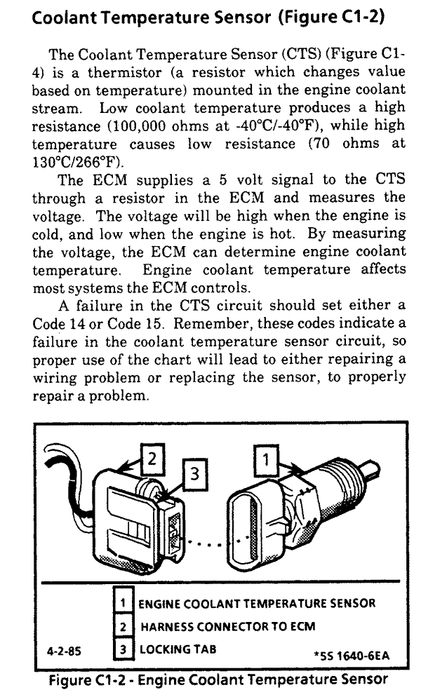

Here is a picture of the Coolant Temp Sensor and an explanation of what it does. It is located in the front of the intake manifold below the throttle body. And there is a cold start injector on the 2.8L V6 engine.

he gots the L98 though

I know he has the L98 in his car, I just mentioned about the 2.8L having it because of the reference to the cold start injectors that's all. Not trying to confuse you or him. No, I don't have these pictures hosted anywhere. I have the GM service manual scanned into my computer in adobe acrobat PDF format and can reference to what I need, and use photoshop to convert it to a usable format for the board. Makes for a nifty show and tell doesn't it?
