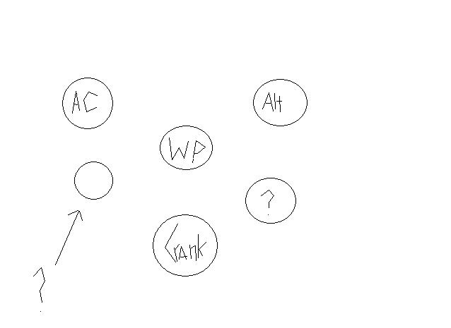

ac seems fine but the only belt driven acess that dont move is the one with a arrow pointing to it. is it suppose to move? my dad said masybe its a glide wheel but idk.

If that pulley has three little bolts attaching it, thats your smog pump and they can have a tendency to lock up when they get old. They're not that expensive and its a lot better than your a/c being locked up..

sounds like your belt tensioner locked up on you if so its a common thing to have happen and you can go to an auto parts store and pick up a new one but they can be a little pricey any where from 50 - 100 bucks but that maybe what you got there not for sure without a pic thou

Its not the tensioner if its in that relative position (beneath the a/c compressor... the tensioner is to the drivers side of the a/c compressor).. It would be the smog pump (but check to see how the pulley is attached to make sure like I said).. However if it is the tensioner pulley, you can go to a parts store that sells bca/national bearings and ask for a S203FF (its like $5). Then a hammer and a couple sockets later, you have a fresh tensioner pulley..

yea it was smog pump, after i get a replacement bottom bolt for the new smog pump my car will be back tearing up the streets again
thanks guys!
oh and the somg pump was 45$ 15$ core at autozone.
