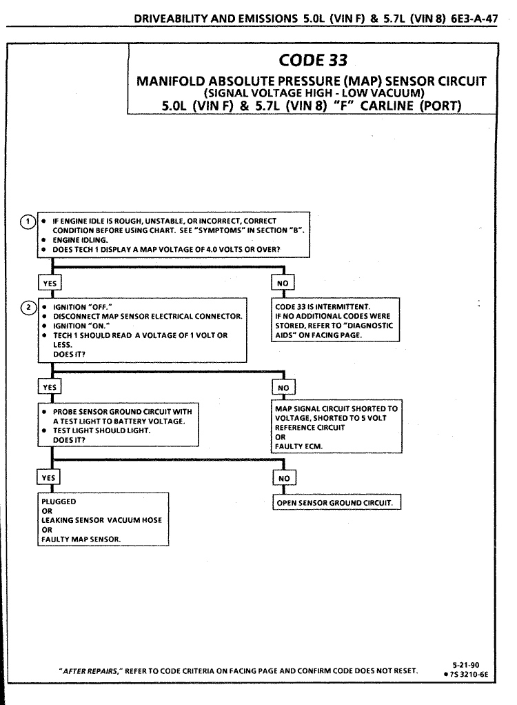

Hello dj haf,
Man, I goofed when I set you that e-mail with the pdf file. For some reason I was thinking MAF and you have a MAP in your car. Anyway, here is the right troubleshooting chart for it.
