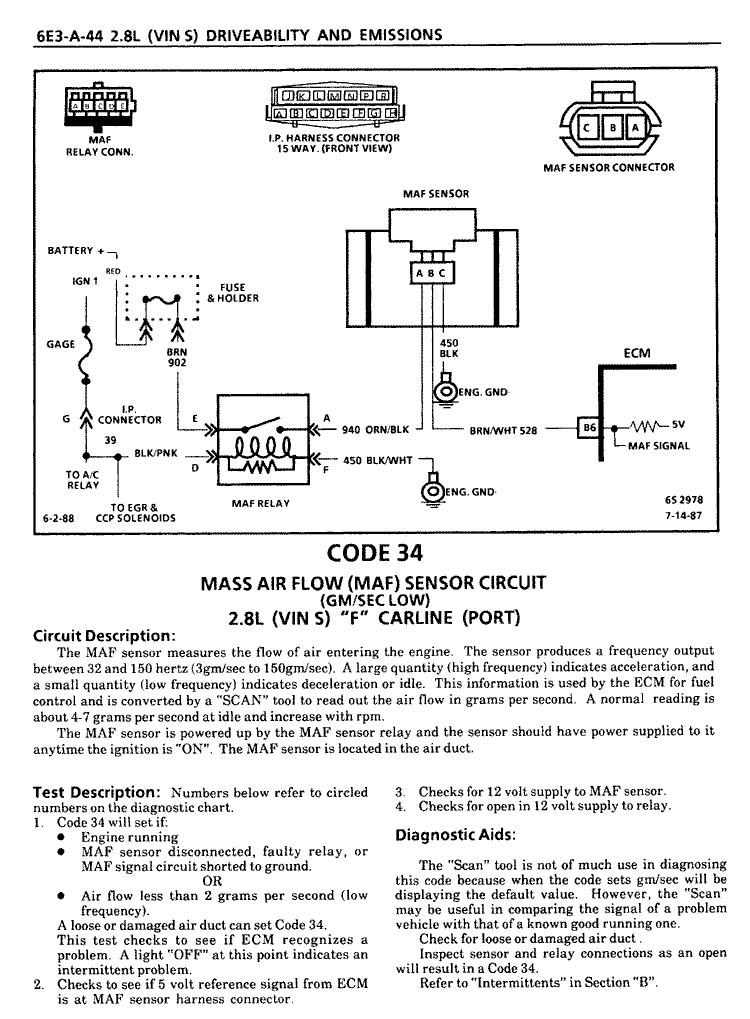

Trickster was nice enough to post this
in another thread regarding code 34. (MAF low) Although thats the 2.8, it's similar enough in the area where I think I've found my problem. (I used the '88 manual for V8 in my diagnosis though so there is no confusion)
In the above diagram, ckt 528 is the one I'm dealing with. V8 is the same, 5V reference.

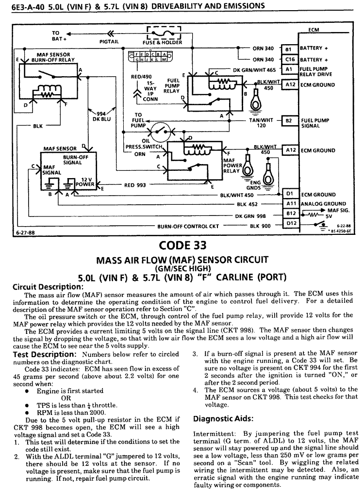

Here is the code 33 chart for the TPI setup and as you can see there is a big difference between the two. Hope this helps and let me know if you need the one for code 34.

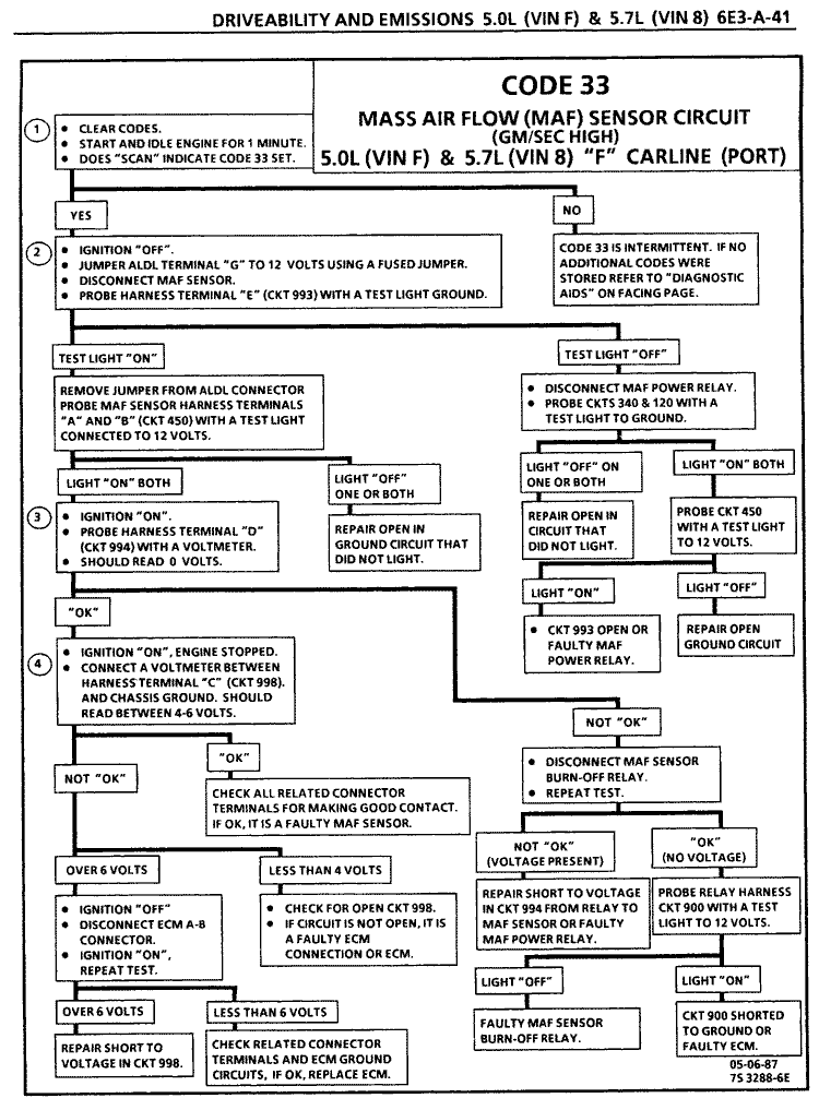

page 2

#4 on that first page.
As a matter of fact, on the flow chart too.
Isn't ckt 998 supposed to have 5V to it with key on, engine off?
Regardless of everything else that comes before in the chart and in the wiring schematic, isn't one constant the 5V on ckt 998 if the MAF is disconnected? I don't see anything in that chart that indicates something has to happen other than the key being on for that 5V reference signal. Am I interpreting the manual wrong?
The first time I went through the flow chart, where it says test light, I used the voltmeter. Is there some reason they use a test light in certain parts of that chart, and voltmeter in others? If there is a reason a voltmeter won't work for those tests, thats where I went wrong originally.

There should be between 4 - 6 volts on that circuit with the key on engine off. The reason they say to use a test light in some area's and a volt meter in others is this. In some of the tests they are just checking to make sure there is voltage present. In other parts of the test, they are looking for a specific voltage to be present. If you can use a voltage meter to determine that voltage is present in these tests that is fine and won't be a problem. It is just the way the manual is written for the mechanics.

If theres one thing I've learned, it's to listen to what others suggest, so I'm going to back and follow the flow chart again. Really not looking forward to it, but the chance always exists that I missed a step or just didn't have a good connection to ground when looking for voltage, etc.
Thanks for your assistance, I will go back out and try again.

Well, turns out I must NOT have had a good ground when testing. Now that my understanding of the MAF setup is better, with it disconnected, the code 33 should be normal.
Chart lead me to bad MAF this time, so I'm on the hunt for one of the Wells units. Not many places around here carry Wells, but at $60, (compared to $160 for cardone locally) I'm willing to work on finding one. Still need to buy one locally so I can return it if for some reason diagnosis was wrong and it's not the cause of the 33, but I will be sure to follow up whether it solves the problem or not.
