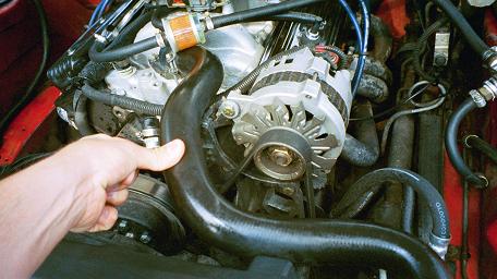

You don't have to run the passenger side bracket at all if you don't want to. I decided to ditch mine. I made my alternator adjustable. The belt doesn't run over that much of my water pump but I have yet to run into a problem with my setup and its been on for over a year. 50.5'' belt.

Here is another...
Man I hate posting these pics....looks terrible for some reason.
