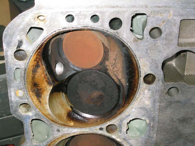

There isn't a whole lot of material there until you run into the coolant passages. I suppose I could get a few cc's off there...get it close, but I don't want to ruin the burn characteristics of the chamber.
-Mike

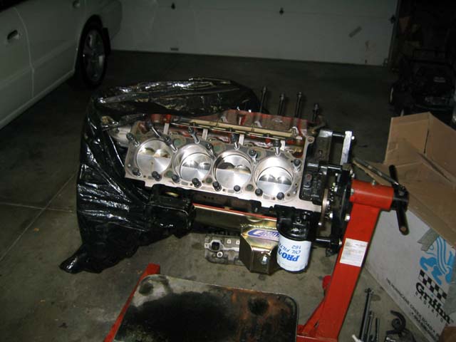

HELP ME I NEED HEADS!!
