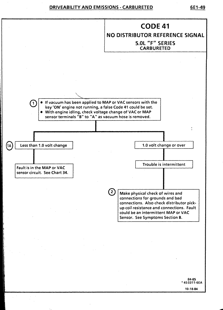

Before things get a little confusing here on your code 41. Here is the code 41 troubleshooting chart from a 85 firebird GM service manual for the LG4 engine. Take a look at it and see if this will help you.

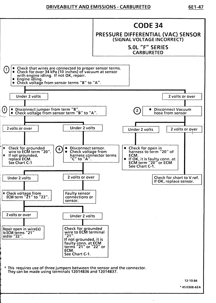

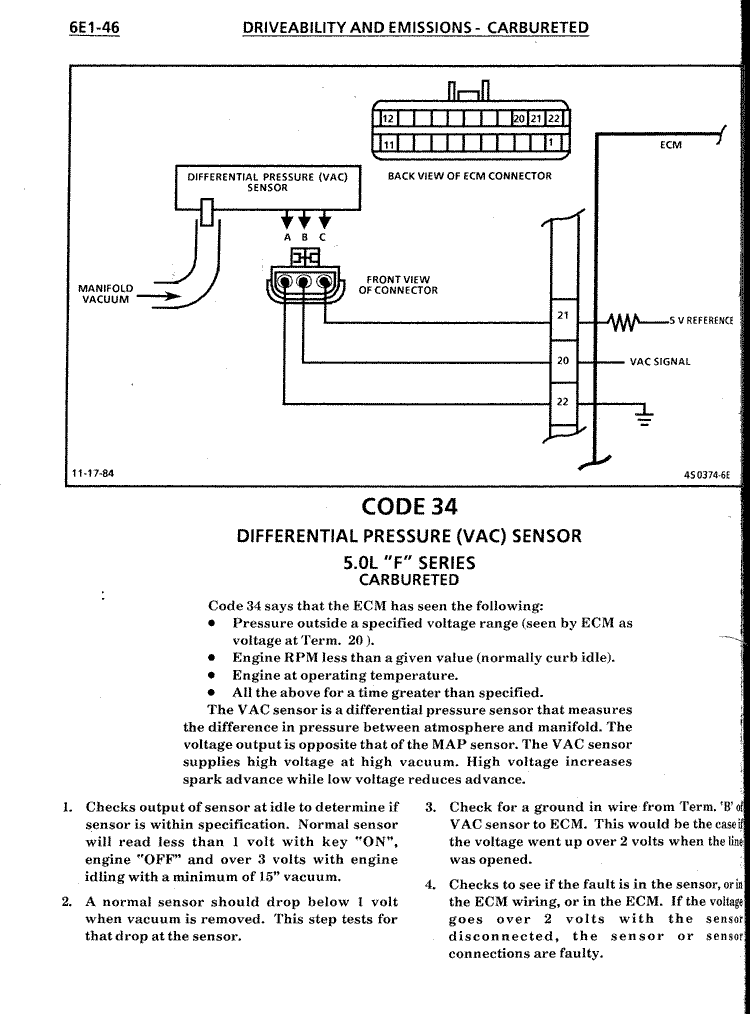

Thanks for the diagrams, Trickster!
I'm having a hard time understanding everything, but from what I can gather the cause could be a bad MAP sensor. Is this a correct assumption?
Do MAP sensors just go "bad" like that? I don't believe I have messed with the MAP sensor since I bought the car, unless I worked on it wihout realizing what it was.
When I check it, I start the car, remove the four wire distributor terminal and place a voltohmeter on terminal "a" and "b," correct? And then I remove the vacuum hose and check for a voltage drop of 1 volt or more? What then?
What should I do if the MAP sensor is bad? Do they sell replacements in auto parts stores?
Sorry for all the questions, but this stuff seems very complicated to me and I don't want to break something else trying to fix this code 41.

You're welcome for the diagrams Nate86, just a couple of guestions here. Are you getting a code 12 along with the code 41 or just the code 41. Also, the two wire connector that you found. Are you sure it is two green wires and not a light green and a light blue wire? If it is the blue and green wires, it probably goes to the pressure cycling switch for the A/C control head and would explain why your heater and A/C doesn't work

Not a problem, as you have noticed the diagram includes a picture of the HEI module (ignition) and the pick-up coil. As mentioned in the diagram, code 41 alone means the problem is intermittent and you have verified that with what you have mentioned in your post. The ses light will come on momentarily when you first turn the key until the engine starts and the light will go out. This is normal. If would like, I will post the info in the chart 34 that is mentioned in the diagram. It is the chart for the MAP sensor.
