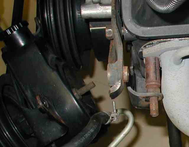

Attached Thumbnails Power Steering brace with headers-front-upper-side-view.jpg

where do I get one of those? That spacer thing, and the stud bolt to go with it.

The stud is stock.
Make the spacer out of a piece of galvanized 3/8" water pipe.... a "pipe nipple" from Home Depot would be perfect. Cut it to the length such that its length plus the header gasket plus the header, equals the thickness of the stock exhaust manifold.
It's pretty senseless to go against the flow and re-invent the wheel, when it's that easy to just use what's already there.
