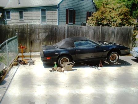

i have a 89 gta with a 350, i have installed new pistons and want to know what the stock cc of the compression chamber is?

Ok, you've got a start. If you don't have headers, I would go that route as your next mod. From there, how handy are you with tools and is this your DD? from the looks of the picture you posted, I'm going to guess not. If you have the time, i would look into porting/polishing your own heads. They can be made to flow on par with Vortecs with the right work. Look up a guy named Sitting Bull. He's got some excellent instructions as to how to go about it. It's a lot easier than it would seem. By working the combustion chamber over, you also reduce the compression a bit, which, with those pistons, wouldn't be the worst thing in the world. Once you do up the cylinder heads, then you will really notice the added power.
