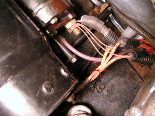

Went and cleaned the connections, but before I put them all back on, heres the way I had them. The only one that looks sorta weird is the one with the two wires (very bottom). Not sure if I have those right. The small nut is against the starter, then the starter brace, then wires, then larger nut.

pic would help eh?

From looking at that picture, you have the fusible links connected in the wrong place. They should be connected to the same post as the battery cable on the starter solenoid. There should also be a copper strip coming from the starter and connecting to the bottom post on the solenoid.

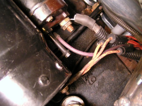

This Correct?

That is the correct routing for the fusible links. Look at these pictures and you will see that copper strip that I am talking about. That copper strip would connect to that long threaded rod with the nut on it that you have shown in the picture.

Thanks for the help everyone. The fusible links in the correct place did the trick.
