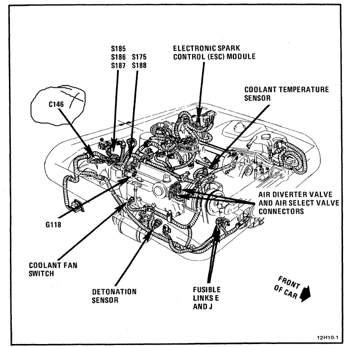

Try looking here by the A/C condenser on the passenger side. It might be hidden inside the wire bundle.

Got it guys! It was tucked between the two harnesses way up near the top of the engine compartment. It was invisible until I saw where to look for it.

Try looking here:
Old Sep 5, 2004 | 03:35 PM
Morley's Avatar
Posts: 4,099
It can also be found forward of where it is in Vader's pic, by the strut tower on the passenger side.
