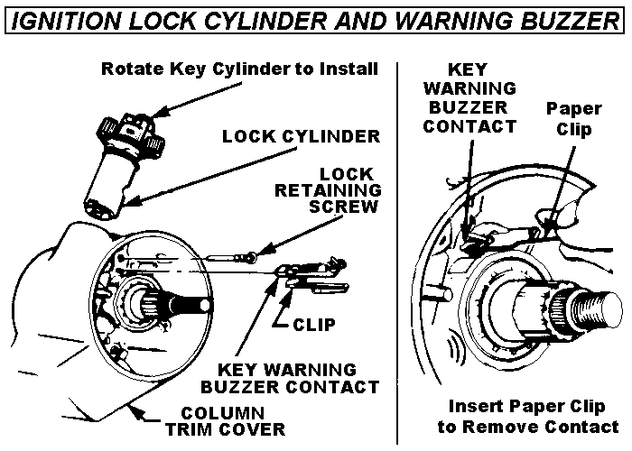

Well Vats is no longer an issue....Guess what I will do is take the steering collum (sp) apart as described in the chiltons, then go from there. I dont have a problem with braking stuff when removing. I just want to be able to replace it with a new unit. Thanks for all your help and suggestions.
