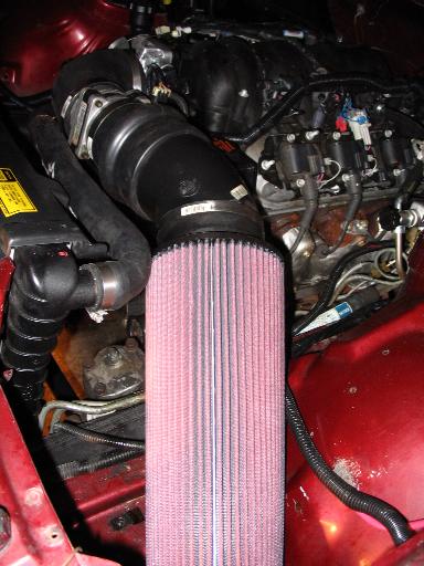

just for the heck of it, heres my TEMP air intake...
eventually it'll be thru the "battery tray" and under the car so its a cold air intake.... right now, its just because i dont like running the car without a filter..... (but i like running the car)
get a load of the size of my air filter...... and they say size doesnt mean anything...
(if you're curious, that wire sitting next to the filter goes to my amps... before im done, it'll be routed under the engine and attach to the back of the alternator, with a inline fuse under there somewhere... )
98s are diffrent.. for alot of things..
