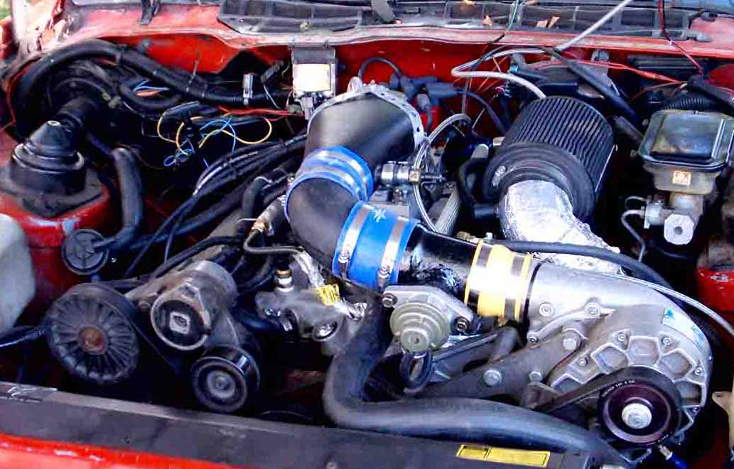

as the owner of a freshly built blown 400 SBC in a 3rdgen vert.. i can tell ya.....
... i kinda wish i went with the LS1..
you can get the engine/ trans combos for 3k-5k now.... thats less then a 400 engine build and a T56 setup. the only additional cost is the engine mounts... (t56 crossmember is the same)
if i went with the LS1, i could have similar power output as my car did N/A, but i can also drive the car distances i cant with my badass solid roller setup.
and i love roadtrips.. and i drive too much... i put about 2k in miles a month... not from commute.. no, i live less then 3 miles from work... i do it because in the evenings, esp in the fall, i just drive around.
the 400 is killing me doing that.... and i cant race it without a cage now.. even a bar isnt enough.. meanwhile with the LS1, it could still bracket race (and need a bar, but not a cage) and i could atleast have perfect street manners.... not as brutal atleast..
im not pro one or the other... im just writing my personal experiance and feelings on the subject at this moment....

My stock (hah) looking thirdgen:

OBTW Anesthes, you really need to clean up that engine
bay, especially the wiring. Looks like a electrical fire
just waiting to happen.
