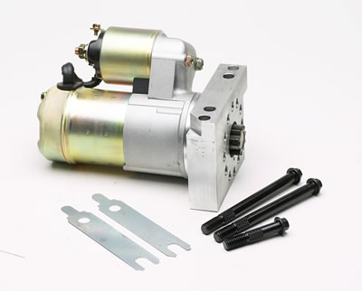

They didn't include enough shims. I gave it a try anyway, and it sticks for a second after the engine starts. I'll get some more shims and try again this evening.
I see what you mean about the starting differences. It'll take a little getting used to (actually sounds/feels like it's turning over slower). I did drive it around a little to get it warm, I usually keep it below 170 at the track, got it up to 190 last night. It turned it right over again (although admittedly it hadn't completely heat soaked with what I did).
Oh, the vehicle voltage seems a little better with the remote solenoid. Probably established a little better contact with the battery cable when reconnecting it.

I rechecked the clearances per the instructions sheet - .100 +/- .040" between face of the starter gear and flexplate in retracted position - it's .140" (no adjustment available for this).
.010-.030" backlash in the engaged position - tried everything from next to nothing to over .040" - still the same thing. When the engine starts, it doesn't disengage for a few to several seconds.
I watched it just running the starter with a remote starter switch (ignition off) - it would remain engaged more often than it would disengage. It was most likely to disengage if the engine rocked backwards after I let off the switch. Just pulling the pinion gear out, it would stay out even though it wasn't being held by the flexplate.
Is this "normal", or do I have a defective starter? Can I expect it to "loosen up" with time & use?

Okay, took me until today to get them on the phone. Described how I had installed it, clearances obtained, what it was doing. "Bad Bendix." They're shipping a replacement Monday, with a return shipper for the original. Didn't argue, hem, or haw, just offered to ship (w/o me having to send back the one I've got first).
I hope their bending-over-backwards-ness isn't based on their experience with the product.

The replacement starter arrived Wednesday. The Bendix does move more easily than the first one. Finally got it installed last night (knee was scoped last Tuesday, kind of limited my activities), acts exactly the same way.
I'm tempted to put the factory style back on and let Summit have their little starter back. So far, I'm not impressed. I'm thinking the remote solenoid will cure most of the "problem", and at least in Pomona, having an RV with an APU in the pits will take care of the rest...

Any recollection of the shimming details? As related above, it didn't seem to affect operation at the extremes or in the middle. If it is affected by a few thousandths, I may have given up too early.

I think I have about 3/32" or so of shims... like one medium one and one thin one. Kind of alot really.

That's what I used, which produced .025" backlash. No shims (less than .010" backlash), a full pack of shims (over .050" backlash), or where it is, it acts exactly the same - won't disengage when the engine starts.

The Summit mini I got looks like the GM mini in general, but completely different in the little details. The motor is different, the solenoid is different, the mount block is different, the housing connecting the solenoid & motor is different, etc.
http://static.summitracing.com/globa...m-g1660a_w.jpg

I just love returning stuff...
This one http://static.summitracing.com/globa...pwm-9000_w.jpg (PVM-9000) looks more like the GM unit. Perhaps they'd exchange.
Or, I can just go back to the "stock" starter...

This is the one I have http://www.jegs.com/cgi-bin/ncommerc...14&prmenbr=361

You can also get those starters at places like Advance Auto Parts... Try the part number 3510GRHBK.. Its $172.88 and usually available within a day.. (fits 153/168 tooth, looks just like this one that five7kid mentioned)..

I too use the remote solenoid on my standard gm starter and love it. .But i've heard that it doesnt work with the mini starters. It causes the exact problem you have in fact.
See the mini starters use permanent magnets instead of windings. When you stop turning the key the starter gear is still engaged in the flywheel and the starter becomes a generator. With the main post and solenoid post fastened together the electricity generated operates the solenoid and keeps the whole thing engaged.
Remove the bypass and hook the solenoid back up to the key switch and the starter should work normally again.

The good news is that makes more sense than anything I've heard.
The bad news is, why didn't I think of that?
And, why didn't Summit think of that?
And, that means I have to give up the remote solenoid, which I kinda liked, and they probably won't take that back.
Maybe I can use the remote on the Camaro...
I'll try putting it back to "normal" tomorrow night. Too late to get to it tonight.
Been reading this thread and have NO additional content to add as to how to fix it but. . .
The generator thing is kind of interesting except: We've ran them on dirt modified cars with at least three major brands of mini-starters including a chrome GM mini starter, cheap brand, etc. Always ran them off of a Ford solenoid with the solenoid on the starter jumperd to the main post on the starter. Never had any problem. These cars do not run an alternator though, if that would make any difference.
Biggest problem I had with one starter was it had to be shimmed BACK .060 with the supplied spacers.
Hope you fix it, it's these kinds of threads that save ME time, trouble and money!

It's worth a try. The fact that the first one wouldn't disengage when I tried it with the remote starter switch & ignition off does cast some suspicion on the theory.

Five 7- sorry I lost track of this thread for a while. Here's the exact starter I have on my car:
http://www.sdpc2000.com/catalog/698/...ce-Starter.htm
It's only for a 168 tooth flywheel and uses a factory offset bolt pattern just like a full size starter would on a truck motor that uses the larger 168 tooth flywheel. I have used it on 383s and 400s becuase those motors always use the larger 168 tooth flywheel unless they have been internally balanced.
Hopefully you have a 168 tooth flexplate/flywheel on your motor. Also, make sure the block is drilled for the offset bolt pattern style starter. Usually they are drilled for both starter bolt patterns, but not always.

It's 168 tooth and drilled for both patterns.
I removed the bus bar used with the remote starter, and put the battery cable, accessory power wire, and start wire directly onto the starter solenoid - i.e., no remote solenoid anymore.
Drum roll, please...............
It works just fine now.
Guess chevymad's theory checks out. :hail: Not sure why SMasterson's dirt cars don't have the problem. Of course, Fxxd's use the remote solenoid and have a different starter design.
I emailed Summit customer service to let them know what happened. Nowhere do they say not to use the remote solenoid with a permanent magnet starter.

I received this reply from Brad in Summit Customer Service:
"I haven't seen this as a problem all the time, but have seen it happen occasionally. We will look into it further on our end. Thanks for pointing out a potential problem, we appreciate the feedback."
I wrote back suggesting a note to that effect within their remote solenoid information.

Good to know. I use a remote starter and a " Generic " mini starter and have never had this problem. Must have something to do with how much voltage is produced by the starter and how many windings in the solenoid. Obviously it is a problem with some starters but not with others.
