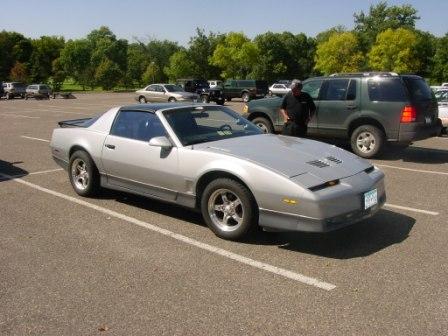

Yeah I am heading back in the end of March next year. I hope the snow, salt and sand will be off the road so I can take the T/A out of storage. So I can fit 12 inch tires under my T/A in the rear with the 4th Gen rear end under it? here is a Pic of my T/A. I just figured out how to get a picture on the website. I couldn't get them small enough before.
