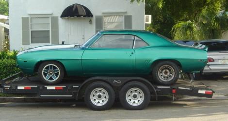

Hurracane jenne tore the roof of my pops warehouse and we broguht home lots of stuf like our 1969 z-28 and a bunch of parts! i have a question i have stage one ported 882 castings on my car and i was wodnering if i get these 354434 castings rebuilt hot tanked and ported will they even be wroth it? my pop said they where fuelies but only the 1.94 versions (well thats what the guy he boguht them form said).so any ideas any help would be thanked btw ehres a picture of the camaro
