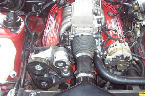

It will probably just be easier to get an AC delete pulley... heck GM even carries them! Basically from my understanding you just bolt the dummie pulley in place and put the belt back on. As for it saving hp by doing away with a pulley I doubt it. I have the AC delete made for the 3rd gens and the pulley is just mounted to a bolt on the bracket so it free spins.

Here's a simple pic I grabbed off ebay.

Well I'm not positive exactly how the LT1 motors tensioners work that's why I said "probably".
I know the 3rd serpentine setups use the ac pulley to pinch the belt against to take the slack out. I've seen the auto tension pulley 180 degree out to pull instead of push to tighten the belt but that's more work too. I've also seen the belt pushed like stock but ran the opposite way around the water pump, which doesn't look right to me.
I guess it plans on what all you want to do, like most MOD projects. I think doing a simple delete pulley swap cleans up a lot of bay.
Here's an example of a 3rd gen swap.
Another thing to say for general knowledge is that autoparts places like to charge weird prices for belts too. When I did my underdrive pulley setup it was gonna be near 30 bucks for the new belt, so I price the belt that was 1/4" longer and it was only 17 bucks. Needless to say I went with the tad longer belt and used the tensioner to pull the slack out, worked fine for me.
