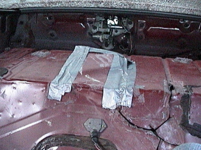

heres a pic of a botched job i found on here wait till you see this mess...LOL

OMFG!!!!!! LOL, that guy needs to be told that duct tape CANNOT be used to fix everything. You have got to be kidding me
Wow, some people, I swear. He must like the smell of gas or something, having all those fumes coming up into the car

Why cut up a perfectly good car?!?!?!?!?!? but hey some guys insist that hacking up a car isnt going to hurt anything thou right....LMAO
i know this is an extreem example of it but still its out there and the ones that are doing this to their cars arent all doing it correctly ....ive stopped to look at a couple thirdgens in the last 6months to purchase and 2 of them were cut up like this or worse...so i dont see a good thing in guys saying its a worthwhile mod at all..
The funny thing is, everyone that posts on here saying they are gonna do it the right way, and not hack it up never post pictures of thier work. They kick and scream and insist its the right way to do it, and thier work will be as good as a factory job, but oddly enough you never see pictures of the end result. If some of the guys here did post pictures when they were done, and they looked good, I would tell them that, but I just havent seen many good attempts at this.

thats because most of them probably look like the pic above...LMAO

LOL!!! I thought that pic was of my car for a second!!!
Dont wory, I didnt do it, the car came that way. I am currently in the process of repairing the lines so they are not connected with only rubber fuel hose. The duct-tape in that picture is dead on correct where the fuel pump is. The other cuts in the pic that are not taped over must have been from experimenting. Mine is not that bad of a job for doing it the wrong way. I am just P-Oed that I have to replace part of the cut up fuel line.
I will try to take Pics and post them so people can see what I did to fix up the mess someone else made.
I came up with many classic cuss word combos but have decided not to share them even by using the * key to edit. This should be a family friendly site.
I guess my vocabulary gets scrambled up when I am extremly frustrated.
Dont wory, I didnt do it, the car came that way. I am currently in the process of repairing the lines so they are not connected with only rubber fuel hose. The duct-tape in that picture is dead on correct where the fuel pump is. The other cuts in the pic that are not taped over must have been from experimenting. Mine is not that bad of a job for doing it the wrong way. I am just P-Oed that I have to replace part of the cut up fuel line. I will try to take Pics and post them so people can see what I did to fix up the mess someone else made.
I guess my vocabulary gets scrambled up when I am extremly frustrated. Last edited by 83ho86tpi; Jan 22, 2005 at 07:24 PM.
