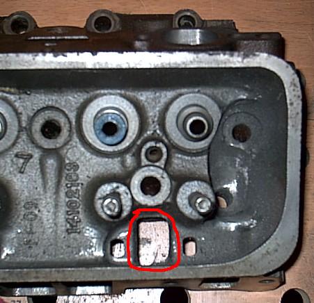

You can just pull the valve covers and use a flashlight to look through the oil drain back holes.
If you see the roller set up (the spider, dog bones, etc.) you have a roller cam.
If you don't, you don't.
Attached Thumbnails roller or flat tappet-tbi-heads-pushrod-slot
