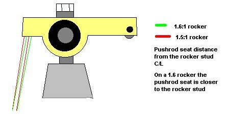

The 1.6:1 rockers will increase the valve lift but also will move the pushrod towards the rocker stud. Your 1982 heads should have a pushrod slot in the head that guides the pushrod. You'll have to carefully check that the pushrod does not contact the end of the pushrod slot in the head with the 1.6 rockers. The cure is to
elongate the slot towards the rocker stud. I do it with a 3/8" rat tail file in a 3/8" electric drill. Could be done with the heads on the car with the intake manifold off and some good housekeeping to catch the fillings in the lifter valley.
