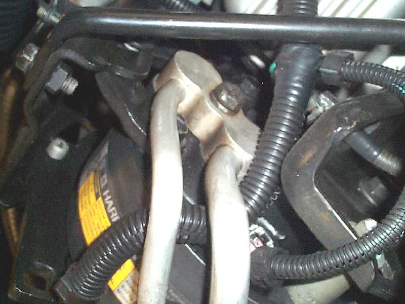

I just found out that when I try to reinstall my A/C compressor on the mount, it hits the tall valve covers I bought for my roller rockers.
There does not seem to be a way of getting it to mount without realy going nuts on the brackets.
The motor is an 87 from a TA with V belts. A/C is on the drivers side with the funky 4 piece brackets and power steering pump.
Do all roller rockers need tall covers?
I really don't want to remove my A/C but I don't see a quick solution unless I can go back to short covers.

See if the covers fit with the new rockers... Stud girdles are the usual culprit. I fit rollers under my old center bolt covers with no problems...Then again , I never had any clearance problems with tall covers either.

Is it the compressor itself that doesn't clear the covers, or a brace? I just checked my '86 (same setup) and have at least 2½" of clearance above the stock covers before there would be any compressor interference. Just how tall ARE those covers?
The rear outlets onthe compressor are the main problem. They need to come down another 1-1/2" aprox. Seems to be the added height of the tall covers. I'll try to scrounge up some centerbolt covers and see if they fit. Perimiters may have better internal clearance though.
also just noticed I put up the wrong pic! you really can't see the bracket when I trimmed it to size.

that's pretty much it there Vader,
I'd better check if the brace will go on too!
Forgot about that.
Well if I go back to the short covers all should be well. Worst case is I have to put my stock rockers back on (boo hoo..)
Looks like you had to do some fab on the bracket too. Was that to get headers on?
Forgot about that.
