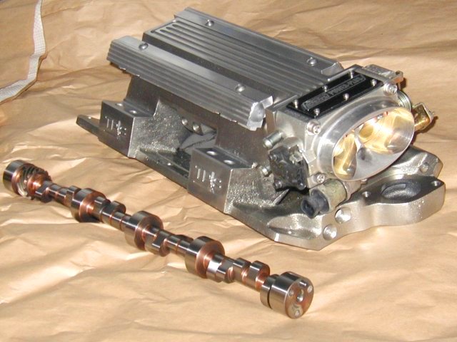

Attached Thumbnails What is MiniRam?-c-documents-settings-rbenjami

The pic I posted is some stuff in my garage, that some one of these days will end up on a short block. I'm looking for something in the 550 HP range, at least. Obviously a Stealth Ram won't do. There will be too many cubic inches in the motor for that.

You can look at the pic, and see how easy it is to get at everything. I haven't run it yet; but, it sure does look to me like the best way to go, for one of these cars, if you want real power, i.e. competitive with a carb.
