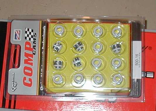

The Teflon seals are the way to go. IMO they're worth the cost to install them. They are the only thing I will bother with on my own heads.
Attached Thumbnails Valves Anyone???-c-old-d-drive

The Teflon ones are "positive". The other "positive" type is like the Fel Pro ones, which are various kinds of rubber materials, which deteriorate with heat and age. They look and work just like the ones in the pic, except they're thicker and larger to fit over some stock guides.
The Teflon ones basically never wear out. They are the way to go if possible. The others are a substitute.
