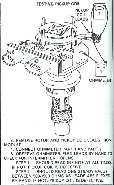

here's the factory service manual method for checking the pick-up coil, but they're pretty cheap (about $12) so if there's any doubt in your mind I'd just replace it anyway. As far as the ignition module there's no way to check with a volt ohm meter that I know of, it's solid state. Autozone might be able to test it, but I wouldn't buy one there

pickup coil tested good so Im guessing it has to be the ignition module. Does anyone know of a good aftermarket one or should I just stick with the factory GM part?
