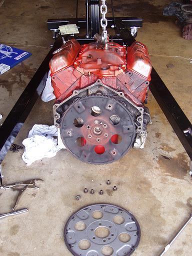

I didnt seem to have a problem removing the flexplate from my 1pc RMS 305 block. But I just got a motor out of a 75 El Camino, and it has a 2pc RMS 168T Flexplate. So I went to the parts store, and got a 2pc RMS 153T Flexplate.
Got all the bolts out of the flexplate, but there's something holding the flexplate in still by the middle. How do I remove this?
Here's a visual:

Just a bit tight due to a corrosion around the crank/flywheel. Spray the area with penetrating oil and tap it a few times with a rubber mallot.

you were right... I just didnt have enough patience with it
