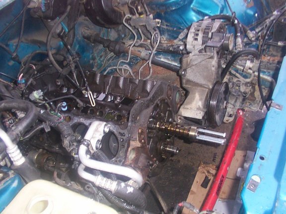

Old Mar 28, 2005 | 01:05 PM
ShiftyCapone's Avatar
Supporter/Moderator
Posts: 13,777
Likes: 567
From: Cincinnati, OH
Car: '90 RS
Engine: 377 LSX
Transmission: Magnum T56
Your back will get a bit sore but that comes with the territory. Take breaks and stretch it out. A cam swap is a 12 pack job so don;t rush. It is nothing that you can't get done in a day though.
This is what my motor looked like right before I put the new cam in.
