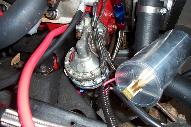

The engine is probably making about 475 HP. Here are 2 pictures of the Edelbrock mechanical pump with the bottom inlet/outlet adapter piece.

Please pardon the mess in the engine compartment. I am in the process of tidying up a bit and routing all of the wiring and hoses. Oh, and here is the third pic, my limit...

Why did you decide to go with the adapter?

Because there is no room where the inlet and outlets are on the original pump. If you look at the 2nd pic, you will see that the inlet fitting is obstructed by the subframe, and the outlet is right next to the block. I have tried several locations by rotating the bottom of the pump, and no positions will work for me. In the second pic, you can see some white stuff(which is teflon tape) at about the 8 o clock position on the outer edge of the pump body. That is the inlet. And exactly 180 degrees around the pump is the outlet.

Ugh, that's pretty irritating. I knew there was a reason I like Carter mechanical pumps better.

Well, what's funny is that the bottom piece that I used is designed for the 70-81 camaro because supposedly the subframe gets in the way of the pump inlet and outlet. Makes you wonder if they got the years mixed up......

More likely Edelbrock hasn't given the product a second glance since 1981.
