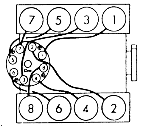

Hi, I was doing work for a friend and need to finish this up but i've got a problem. Its a goodwrech 350, carbureted. It ran just fine before this.... All I did was change the plugs and wires, but now it wont start. It turns over just fine its just not firing... I checked the spark plug gapping and thats ok. Anyone have ideas? I have to finish it up soon.

double check, triple check and then check again on the firing order.
It should be like the picture below.
That is unless he put the distributor in weird so that the numbers are over a couple.
