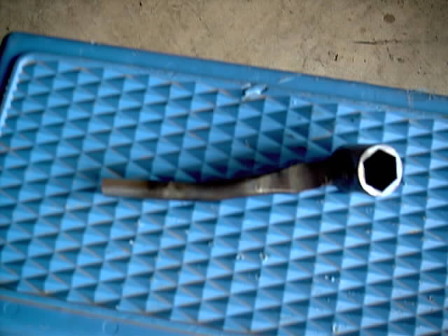

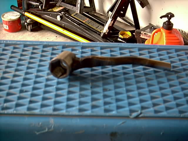

Have a 'special tool' for plugs 2,4,6,8...also use it on 1,3,5,7 sometimes.
Yes changing the plugs can be a real PITA but how often do you really do it.
To get to 6 and 8, I usually get them from underneath....the rest from up top.
OH yeah BTW I have Hooker 2055's. Yes, they do work loose, but from what I hear that is a commonality on all headers unless you get those special self locking bolts....
In fact, just recently was working on the car and pulled the Y-pipe thinking I had a leak at the collectors. Found out it was really on the header bolts around #8. The one closest to the firewall was finger loose and the one between 6 and 8 was G O N E. So I had massive exhaust leaks.
Tightened all bolts and amazed at how quiet it got....

and another
TTT
