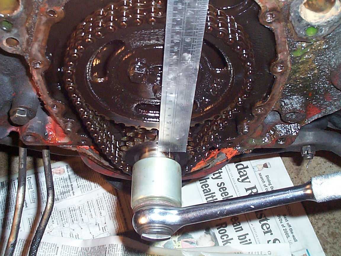

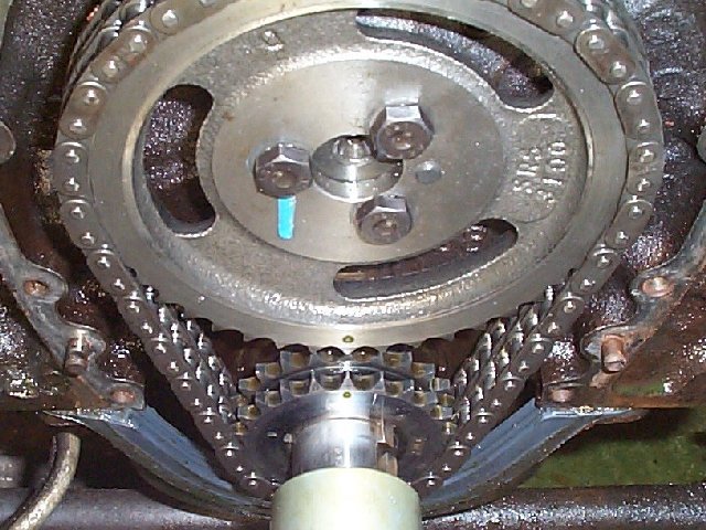

The cam seems relatively tame for a 350. That duration shouldn't be causing that kind of lower RPM problems.
Having said that, the cam installation could be an issue. I've had similar symptoms from one of these:
That's an 18° difference in timing per chain/sprocket tooth. That can cause what you are experiencing.
This is more like what you should have:

What exactly are we looking at in these pictures?
I don't see the difference other than the angle/straight edge.
I exhibit these symptoms in my car.

As for the previous photos, it was on one that I "inherited", and was indeed off by one tooth - 17.75° to be precise. It exhibited the same lethargic symptoms at lower RPMs. The engine ran better with about 30-35° ignition advance (to match the valve events better, and not the piston position) and still made poor power. I'm not the only one who has found this.

The photos of the timing set are from ME, not from 84Z.
Yes, the timing was off on that installation. It caused performance problems and one bent valve.
The timing of a distributor does not rely upon the orientation (insertion position) of the distributor gear relative to the camshaft gear. As long as the wires can be position in the proper sequence and the distributor can be moved, adjusting timing should be easy.
This is a better representation of being off a tooth (or more):
