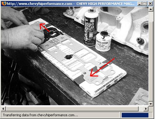

The old intake manifold gaskets dont have this water port blocked off, but the new one does. These new fel-pro intake manifold came from autozone in a head set "HS 8510 PT 4". Autozone and fel-pro's website, and the head set gasket box shows that they made these intake manifold gaskets to fit my 89 Firebird's 305. I did change the intake manifold, carb and distributor but that shouldnt make a difference. Anyway enough with the blah, with these intake manifold gaskets I'm blocking water from flowing through two ports Does anyone know how big of a difference that this is going to make?
here is a pic of what they look like, the old ones just had an open port.

There is no cross flow of coolant at the rear of the heads. Just orient the gaskets so the blocked ports are at the rear.
Since you evidently went to carb, the intak you used may or may not have a coolant hose bibb at the RR of the engine. In that case, you would need to punch the gasket to allow flow.

The example in the attached image in your first post shows an intake with a heater hose outlet at the right rear corner. If your intake has a hose connection at the RR, you will need to punch a hole through the gasket at that location. If there is no hose connection, don't bother. TPIs have no such hose, which is why the TPI intake gaskets have no hole in the gasket.
