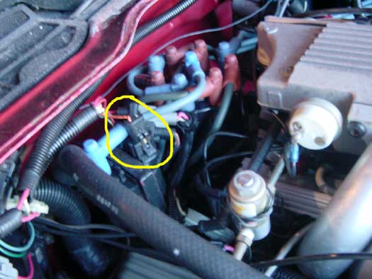

Ignition Connector
Does anyone know what this connector is called? Also where can I purchase one.

That looks like the connector to the coil. Even in the trade it probably doesnt have a specific name.
As its usually part of the wiring loom, best bet is a pair of side cutters, and a visit to the scrap [breakers] yard.

Not sure if thats the power/tach pigtail or the module trigering leads but you can get them both through painless on summit.
If its the power/tach lead then its PRF-60125 on summit.
I think the other piece is also available through GM parts (I got mine there) but you may be able to get painless to sell you one separate from the complete wiring harness kit it ususally comes in.

Does anyone know the GM / Chevy part number?
