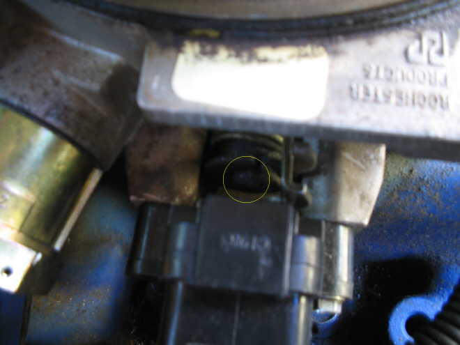

I am suspecting the TPS to be the culprit. I think its missadjusted.
here is the pic.

I know I have one bolt holding it right now, but its a lot better than before when I could move the old one.
The circled thing, can I adjust that???
I'll put some more pics on the TBI board, cuz those guys specialise in the TBI's
