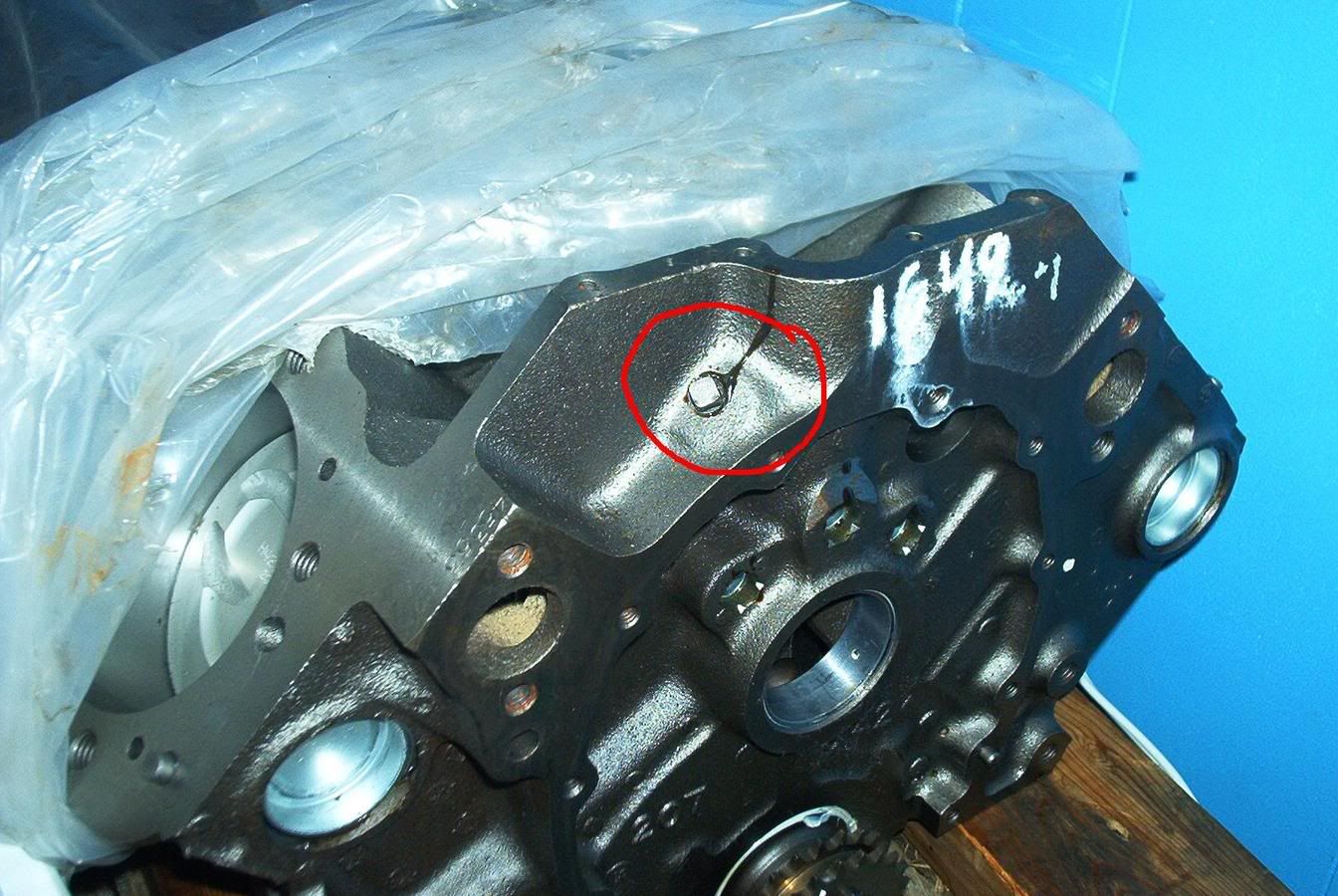

Originally posted by tfg111
is there a plug or something that also has oil pressure to it at that location?
I'm not intentionally ignoring that question. I've been searching for a photo of a later block that clearly shows the front plug. Most later SBCs have a 1/8" NPT plug on the right side just above the timing cover. This is another place to test pressure.

84z28350's Avatar
Joined: Aug 2005
Posts: 3,004
From: Yellowknife, NWT, Canada
Car: 84 Z28
Engine: 357
Transmission: TH-350C
Axle/Gears: 3.43
Give me a second if i can find my camera ill get a pic for you. My 350 sitting right beside me has the plug on the front by the timing chain.
Old Nov 11, 2005 | 10:39 PM
84z28350's Avatar
Joined: Aug 2005
Posts: 3,004
Car: 84 Z28
Engine: 357
Axle/Gears: 3.43
Ok that was more than a second but who would have thought 4 AA batteries were that hard to come across??

tfg111's Avatar
Joined: Aug 2005
Posts: 19
From: hills of tn.
Car: 1988 formula firebird
Engine: 350 tpi
cool thanks for all the info. I'll check the pressure at the front hole in the a.m. and let you guy's know what I come up with. I did install the high volume pump and I'm not sure about the clearance issue but, when I installed it I purchased a new sump with it and installed it at the same angle as the old one.
