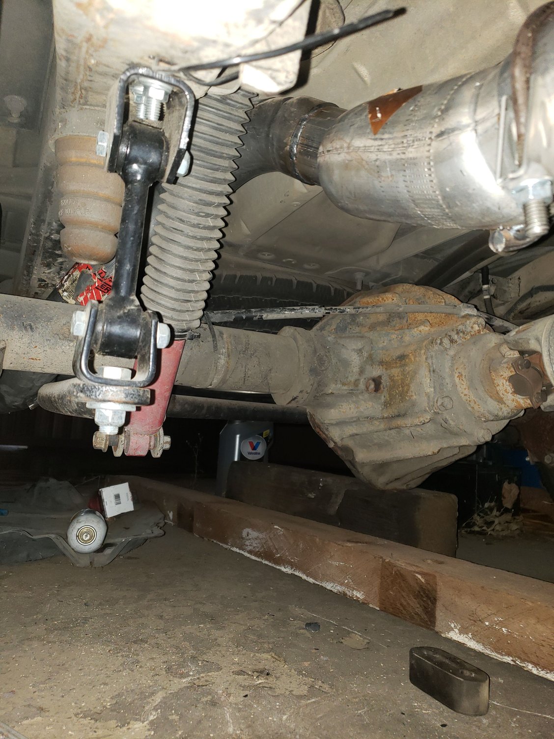

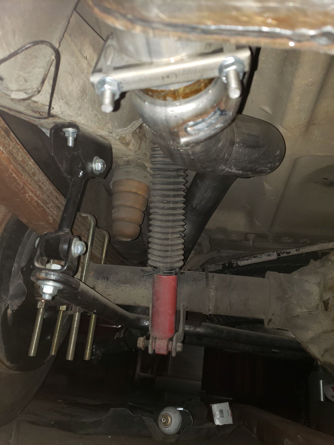

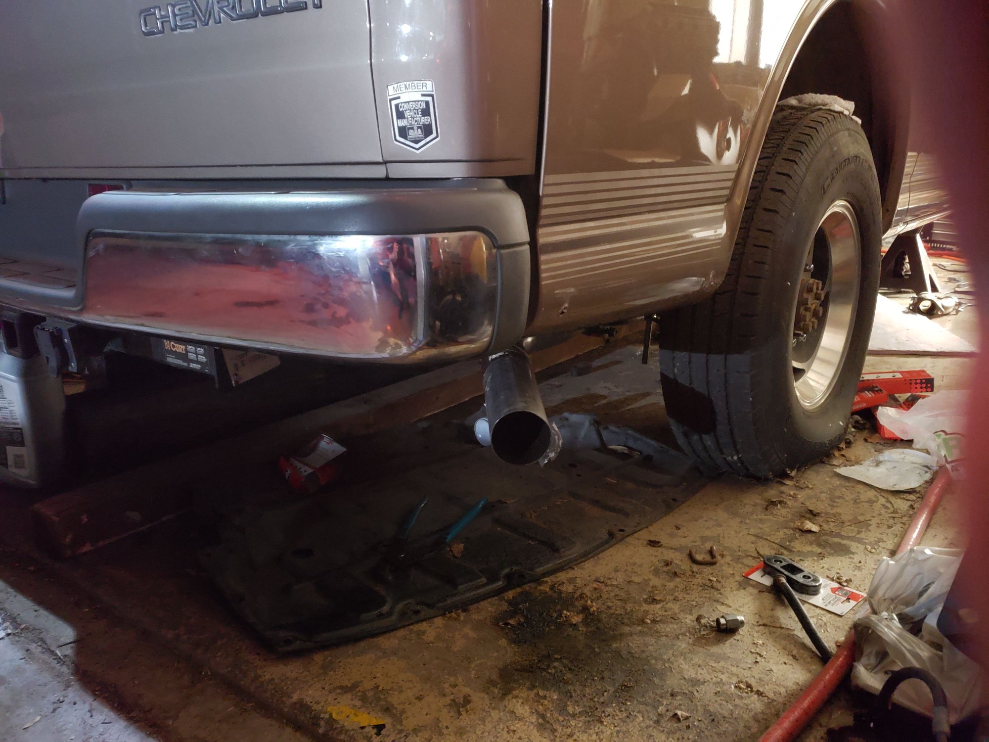

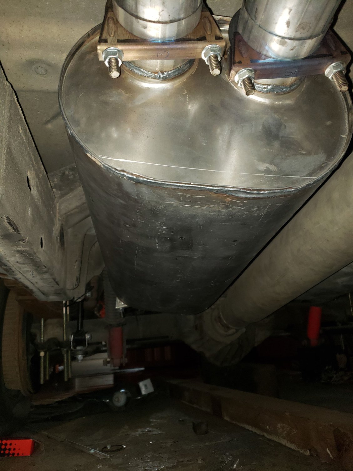

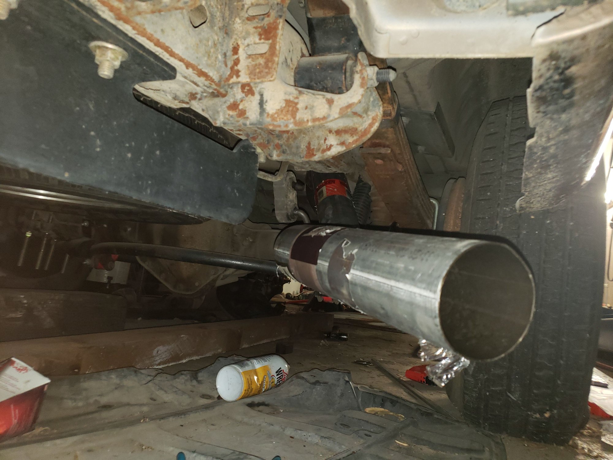

Swapped the muffler and tailpipe on the 97 today. Found a walker quiet flow muffler and matching 4" tailpipe for a 2001-2006 3500HD with a 6.0L or 8.1L at Summit in their scratch and dent clearence area for $110 for the pair. Dual 3" inlet muffler and 4" tailpipe fit my 97 like it was made for it. I'll have my local owned muffler shop I have used for 20 years weld it up for me someday soon. He was too busy replacing stolen cats to get to it today. Couldn't get enough leverage on the muffler laying on my back to get it straight and cannot get enough tension on the clamp to make the tailpipe hang closer to the body but its together for now. Will add a nice 5" or 6" opening tip later. 383 seems unbothered by the change with the exception of being quieter now. Can barely tell it is cammed even much less a 500 hp engine. That being said, dual 3" to the muffler and single 4" out to the atmosphere and its still as responsive as it ever has been. Very little backpressure in this system.
