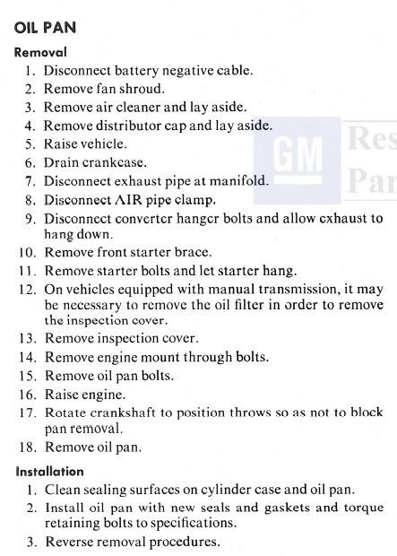

Okay so I got a leaking oil pan gasket. I've seen lots of posts in the past about people removing the oil pan without pulling the engine. I was just wondering if anyone has any pictures of all the work they did. Like pictures of ur setup. I'm looking to use a engine hoist.
Also if anyone has any tips for me before I start this that'd be appreciated!!

It Can Be Done Without Removing The Engine
