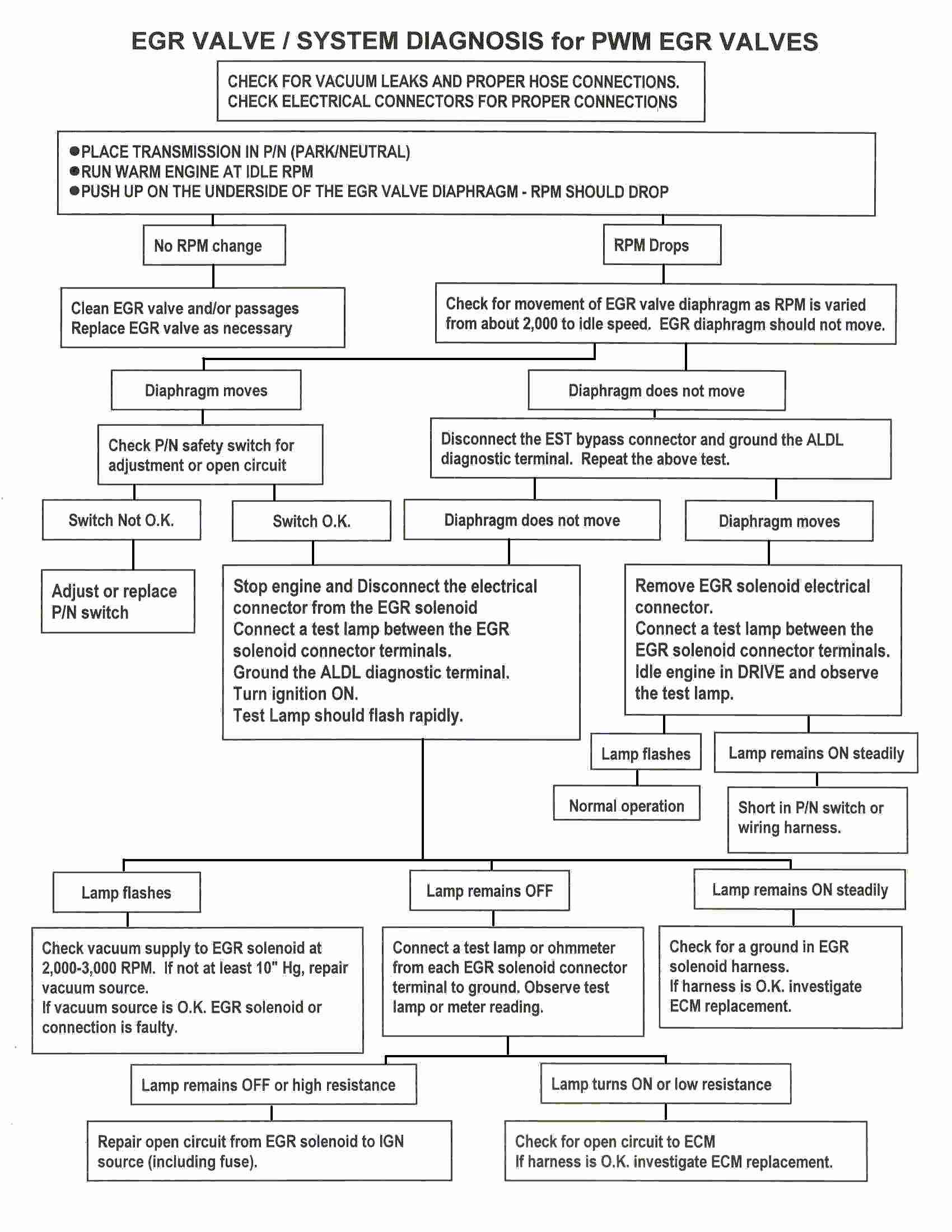

You can try this to help diagnose the possible valve problem:

Thx for the reply Vader!!
Yes, the EGR valve in question is for my 87 TPI eng.
Currently, the eng is on the eng stand, so I can't use the flow chart.
I was wanting to confirm the egr valve ops before I installed the runners and plenum and save myself the expense of having to buy a new set of gaskets for the Hi-Flow runners ($$$) if it does need replacement.
