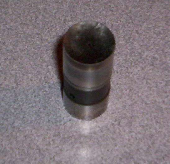

Summit lists them on-line. $171.29 - pretty proud of that EDM hole. $326.29 for XS282 cam/increased oiling lifters vs. $215.83 for the XS274 & regular solids. Oh, well, I'm working some overtime over the holidays, could add that to the attaboy funds, perhaps. I have to save a little bit of it over the purchase/shipping costs to get the rear bearing journal machined for the '65-'66 required groove.

Didn't realise the Comp Direct lube lifters are so pricey.
I'd go with the Howards Cam brand lifters also. or just go with the standard Federal Mogul solid lifters.

Update:
1st, got a used Megashifter for the Camaro from a TGO member (classifieds). Missing some parts, but less than a new one by the time all is said & done. So, that's taken care of.
Now, cam. Going to go with the XS282. I'll have to agree with 'Bird, the XS274 would probably be too mild, or at least not much of a step up from the current 270 hydraulic. From another thread, also going with a regular double-roller timing set.
Now, the lifters. The direct-lube are very tempting, but the funds need to stretch far enough for new slicks as well. So, saving a few nickles & dimes here and there is attractive. I figure I'll either go with the Howards, or some "regular" flat tappet mechanical. Looking at summitracing.com, some non-Comp/non-direct-lube alternatives are:
Crane CRN-99250-16, $79.88
Lunati LUN-70992, $89.95
Erson ERS-E914021, $69.95
Any reason not to consider any of these less expensive alternatives? I wouldn't be surprised if one or more of them are actually made by Federal Mogul or Elgin.

Ive talked with the local machinest about the direct lube lifters. He ran them in his daughters car last season. He dident notice any real difference in cam wear compared to a standard set. I ran the Crane 99250's in my last 402. I dident have any issues the 4000K I put on the engine. I think since the cam has been replaced by the new owner, probably user error or too much cam for a street car.

Well, the order has been placed with Summit. The Ersons got the nod.
Guess someone else will have to tell us about the direct lubes.
