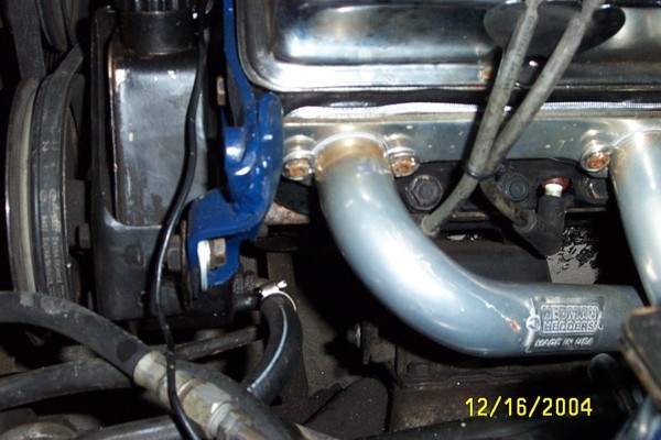

I don't know what Pro Topline based there angle plug off of but they make getting to the spark plugs easy with my Headman shortie headers. Also no burned up wires. Does make it harder to start threading the sparkplugs though, until you get used to the angle they are at.
Pretty crappy picture but you can see they point the front two and back two sparkplugs towards each other.
