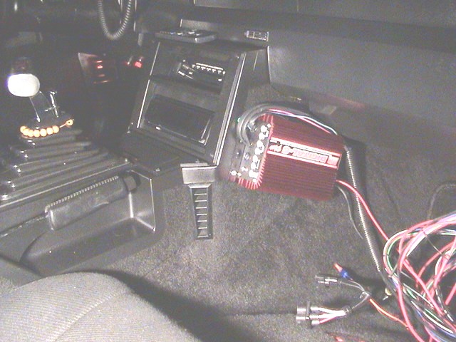

Yeah mine is installed on the right side of the console...and my does buzz also..sometimes loud and sometimes doesnt buzz at all..I called MSD and asked if that was normal and they told me yes..those are the transistors in the box....
this is the best picture I got...I forgot to take one after the complete install...but you cant see any of the wires at all...I installed it there so I had easy access to adjust the rev limit or timing retard for the the nitrous...works damn good..and dont let any tell you its gets hot..cause it doesnt...it get warm...and is far enough away from anyones leg...

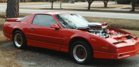

my car isnt really stock, i get so tired of typing the mods....need to get the sig working....pic attached
