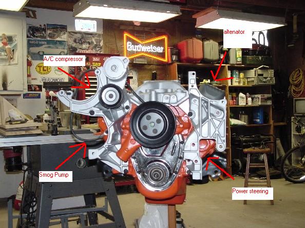

This should give you an idea. If you search there is an article that has the routing and new belt length if you delete the smog pump. There are 2 brackets that bolt to the head and the altenator and one to the a/c compressor.
