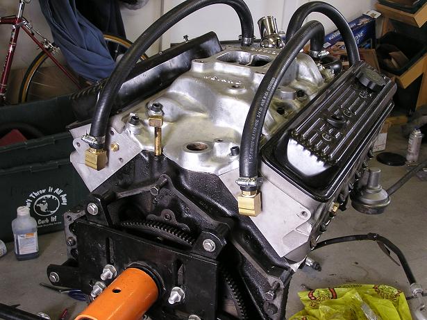

Your not going to find angles washer at the hardware store. You have to buy them specifically for this application. I made mine out of some aluminum tube.
Here is a picture showing my LT1 setup, but you can get what i'm talking about from this.
Attached Thumbnails dart kool can, wont bolt up, suggestions-lt1-cooling-setup-2

Thanks, I guess I will just spend $60 instead of cutting corners. That looks strange, with coolant hoses routed like that, i've never seen it. How would I benefit by plumbing coolant lines through my intake. I have 4 ports on the dart intake to do so, I just don't know anything about benefiting from it. later
