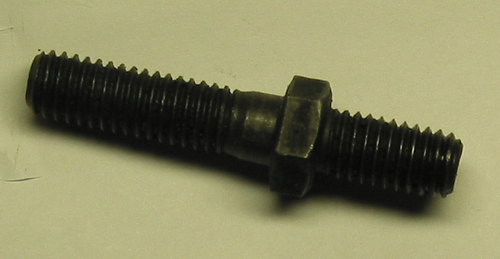

Does anyone know who sells individual assorted varieties of the fastener pictured? Does this have a technical name? Thanks

Not sure from the pic if that's an exhaust stud or a rocker arm stud, but ARP is usually your best bet for top quality bolts.

This particular bolt/stud is from a th350 tailshaft where it attaches a exhaust hanger. You can find these on waterpumps, intakes, exhaust manifolds, etc. I can't find anything on ARP's site that resembles this. I need a selection to choose from. I don't know how to narrow a search because I don't have a proper name for it.

collared stud. it has the same threads on both sides?
say 7/16-14 ? just different lengths?
unequal length collared stud. 7/16"NC threads.
mcmaster carr didn't have any collared studs like that, that I could find.
maybe email ARP. not quite a common enough thing to be on a shelf in a store.

If your not having any luck finding one just make one from some all-thread that is the right thread size, and put a nut on it to set it, like using head studs except with extra threads to hook your hanger to.

thanks kwik and Sonix, I know I can rig something but I'd just like to be able to find a place online where I can order the exact ones I need. I've done quite a bit of searching without much luck. Some call them "collar studs" others "double ended bolts". I've found mfgs who will make quantities to order but no distributors selling a variety in small amounts. I may have to get some start up money and start my own business.

Have you tried Fastenal? Service Supply? Field Fastener?
Try finding double collared studs. Those are hard to find. They have to be made on an open die header, and there aren't many of those left in the world.

http://www.amkproducts.com/Catalog_PDF.htm

I agree with ya Merlin. When I mentioned ARP, I was probably referring more to "convenience" than quality. You especially drove the point home by using Accel as another example! I would take Vader's suggestion and try Fastenal or some other bolt supply place. If that fails, there's always the good old boneyards. I've probably got a whole organizer drawer full of studs like that from tearing down misc. engines over the years.

Sonix, that one's going in the favorites. A bit pricey but it'll do.
