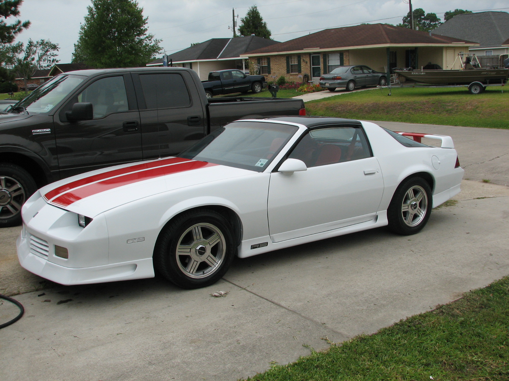

I have been a member for over eight months, and this is the first time I feel the need to post. The search button has been awfully wonderful to me. I knew nothing about these or any other cars, but thanks to you and only you, I have installed spohn weld in subframe connectors, spohn front and rear sway bars, spohn wonder bar, poly bushings, bilstein sports, sportline springs,and complete front end rebuild kit. I have never driven a car that has handled so wonderfully.
SO to the point. I bought a complete racecar (a stripped down nova) from this guy that I work with for $3000. All I wanted was the engine and tranny so I am currently selling off the parts that I don't want and have collected $500 for the rims and rear end so I'm only in for $2500.
The engine has all forged internals with iron eagle heads ported, polished and shaved down to 55cc combustion chambers coupled with srp forged 11cc domed pistons (jegs #867-140678) and a really aggressive cam, he said it produced 590 horses at the crank. He also has a nitrous extreme kit with a 100 to 200 adjustable shot that was included. My problem is that the combo produces almost 14:1 compression.
All I want to do is get this engine streetable on pump gas and into my car with as little additional investment as possible. If I get new heads and cam I would like to spend about $1500 to $2000 because I don't want to put crap in my car.
Jegs sais that the pistons with 76cc combustion chambers will produce 11:1 compression and with aluminum heads, this should be doable. I would think something like afr 74cc aluminum heads with a big gasket would get me there, or would changing to a flattop or dish piston and keeping the same heads I have on there now be better.
I don't want the fastest car around but I would like 375 to 400 at the crank for this car (92 rs 305 tbi) so I think I will switch to carb Because I don't want to tune the tbi.
PLEASE HELP AND CRITICISE ME (but forgive my ignorange)

No the racecar and engine was a nova. the camaro has been mine for over a year and is still bone stock in th engine department and is ready for a transplant. Sorry for the confusion, I now have a tired 305tbi in the car, and an awesome engine in the yard, waiting to be dropped in.
