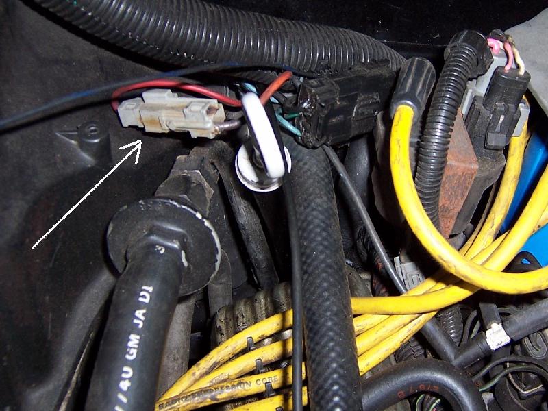

Alright. I'll help, but you may not like my answer. The starter requires a large amount of current to "pull-in". So much that they can't fuse the circuit with anything but a fuse link. We're talking a current surge of close to 60 amps. If the teeth are not aligned the solenoid must pull hard enough to compress the spring that pushes the bendix out until the starter turns and snaps the bendix in. If it's not the starter or battery, the problem you are having is low voltage on the solenoid pull in wire. It is age and heat related. There are several places that can bottleneck the power to the solenoid.
1) the fuse link and connections that feeds B2 & B3 terminals on the ignition switch.
2) the ignition switch contacts and terminals.
3) the gear select switch (makes sure it will only start in neutral), or clutch switch on manual transmissions (makes sure it will only crank with the clutch in).
4) the bulkhead connector that carries the power from the above mentioned switch to the purple wire on the solenoid.
The circuit that supplies power to the key switch is prone to bad connections (from age and corrosion) that will heat up from the voltage going thru them as the car is being driven.
When the car is turned off the circuit will now not provide enough amps to engage the starter.
For those guys in Rio Linda, I've included a picture. This is what we're looking for. Connections that look like this:
Attached Thumbnails Need Help!!  Mini Starter on- still no hot start...-100_0234_c.jpg

Let me clarify. The solenoid will pull in fine with 6-8 volts when it is cold.
When it is hot it will have to have full voltage to do the same task.
