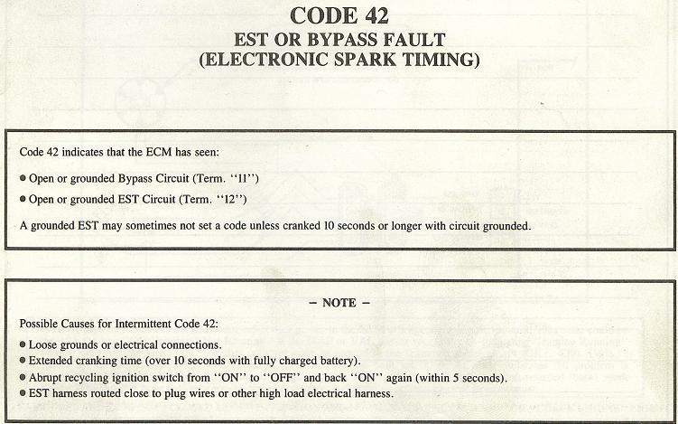

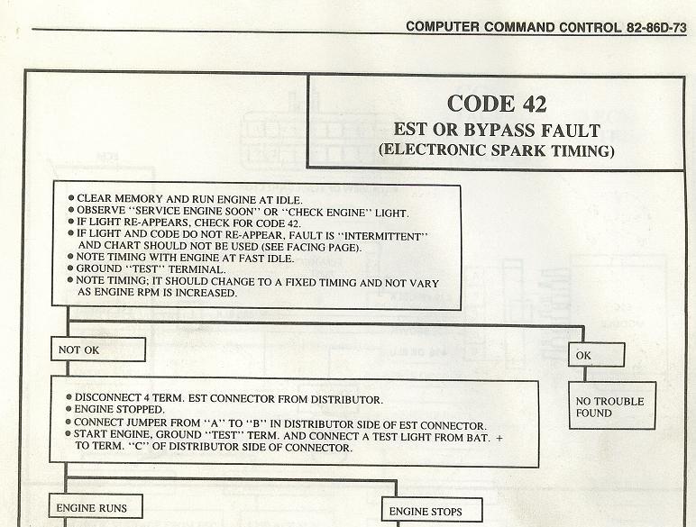

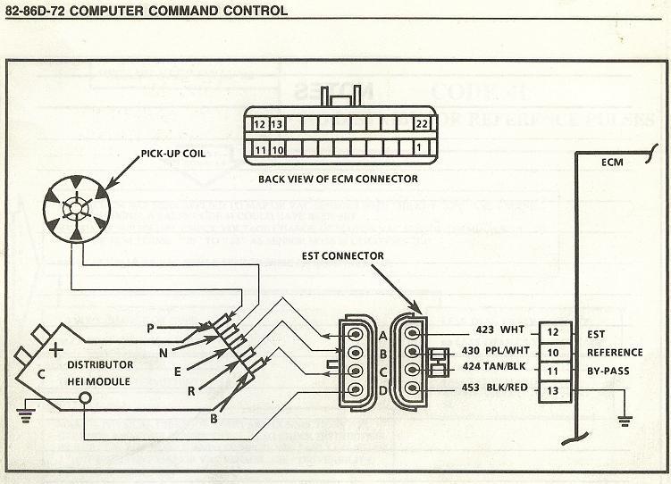

Here's the flow chart for code 42
Attached Thumbnails code 42-code-42-1.jpg   code 42-code-42-2.jpg   code 42-code-42-3.jpg
